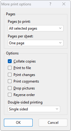

More options
Click on the "More options" link at the bottom of the dialog box to open another dialog box with additional printing options:
file_print_dialog_options
▪Pages to print
Here, you can specify whether all selected pages or only pages with even or odd page numbers should be printed.
▪Pages per sheet
TextMaker usually prints only one page per sheet. However, you can instruct the program to output four pages (scaled down accordingly) per sheet at a time.
▪Collate copies
This option specifies whether to sort the print output by page number when printing multiple copies of a document.
If you enable this option and print multiple copies of a document with, for example, three pages, the pages will be output in the following order: 1-2-3, 1-2-3, 1-2-3, and so on.
If it is not enabled, the order will be: 1-1-1..., 2-2-2..., 3-3-3...
Note: Not all printers support this feature.
▪Print to file
This option redirects the print output to a file instead of a physical printer.
▪Print comments
The comments are also output in the printout.
▪Print changes
Highlighting for all changes to the document that were recorded with the "Track changes" function are also output in the printout. For more information, see Reviewing documents)
▪Drop pictures
This option skips all pictures and drawings when printing (useful for fast test printouts).
▪Reverse order
This option prints the pages from last to first.
▪Double-sided printing (Windows and Linux only)
Instead of Single-sided printing only on the front of a page, you can set here for printing to also be performed on the back of a page ("duplex printing"):
Double sided, long edge means that you can turn the pages like a book.
Double sided, short edge means that you scroll the pages upwards like a clipboard.
Note: Your printer must support duplex printing in order to be able to use this feature.
